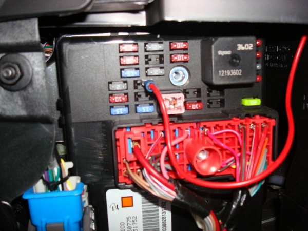

I used this location with an in-line fuse. Not sure what number it is, but it is switched on/off with the ignition. Even has the delay like the radio and windows.

Depends on what you want. Fuse location #21 (a spare slot) will give you key controlled hot, fuse location #28 (also blank) will give you constant hot.
The one esmarkey is showing is location #22. I don't know if that one is constant or not. You would also be wise to make sure you use an inline fuse to protect your equipment.

Thanks guys.. I plan to tap into fuse #22 with the following:
http://www.amazon.com/Littelfuse-FHM...=pd_sim_auto_1
That is the wrong size, but the type is even safer than in in-line fuse as it moves the fuse back to the sorce.

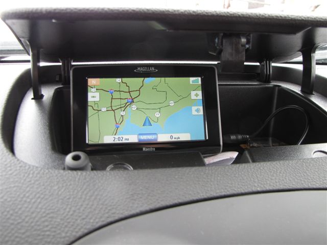

I went a different route when I did mine after I hard wired it to the power outlet I put in a 3 amp in line fuse then ran the wire up to the glove box.On the backside of the lid there is a little shock absorber for the arms.I just slid it up some till the lid opens just enough to see my GPS.The lid is still low enough that it does not block your vision of the road.

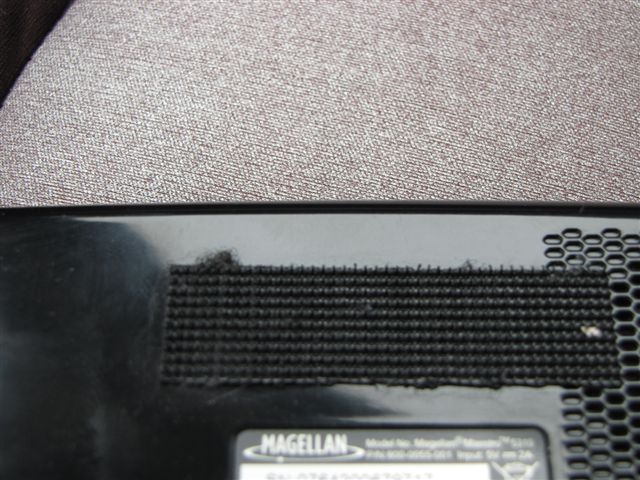

All I did was put a bit of velcro on the inside of box and backside of the GPS when I use it I just set it up and aline the velcro.When I park it just pull it off the velcro and lay it down and shut the lid out of site.
Best part of doing it this way is the screen is always shaded and is nice and bright on the sunny days in any direction you drive.
