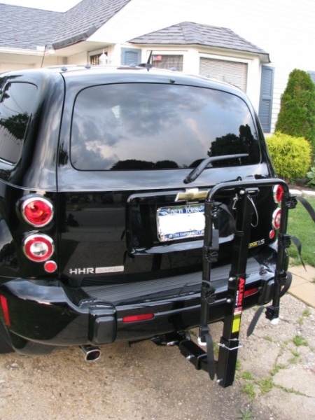

Here's Pics

^ you need to paint your muffler..
looks nice and blends in nicely with the black paint.
do you have some side molding on your doors?

Yes-side molding on doors plus leftovers placed on rear bumper. Molding is called "Camaro" molding. Saved car from lots of dings. Blends in nicely as gloss black. Also made in colors-check to see if there is a body supply distributor near you. Comes in 2 7foot pieces with custom molded ends. Do not get formed ends-they are made by splitting the ends and glueing them back together-bad look.
