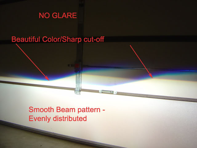

the HIDs ARE an upgrade, but not the best upgrade. u need to get projector lights if u want the "cut-off". u can get the projector housings off ebay for around $200 for the pair and fab them in or if u search this forum u will find a guy makes some real nice projector headlights for about $600-$800. the only difference in putting hids in the stock hhr headlights and projector headlights is the cut-off line.
the stock hhr headlights do not have this line so the light is reflected everywhere thus giving u "glare".

projectors with HIDs

Cool , no prob. We are on the same page here. I just wanted for the originator and anyone else interested to know that HID's that do not have "lenses" are bootleg, sub-par, cheap. That why the price is so low, and retofits are so high. This sound like a knock, but what i am trying to say is that polished aluminum is NOT chrome. If you want chrome, do it right. If you dont mind having lights that look like $70 retrofits than that is your choice. If you want to "look" like real HID's (bmw, merc, audi, etc) then get the REAL thing. Do what you want with your hhr. I just want people to know that under $ 500 retrofits are like bootleg dvd's. Everyone knows what they are. No one is fooled.
Your stock headlamps are great, many complain of "flashing" with just the stock halogens. I beg anyone, do not put the equivalent of (as i hear it put here) a "fart can" muffler on a 90 hp engine. You will be a laughing stock. And from a scientific standpoint, you will not get anywhere near the clarity, intensity, or distance out of the stock hhr HALOGEN REFLECTOR hedlamps over a true projector. Dont take my stupid rant to heart.....take a look at the next standard HID car, and look inside the headlamp. You will NEVER EVER see a reflector halogen housing! I promise....
