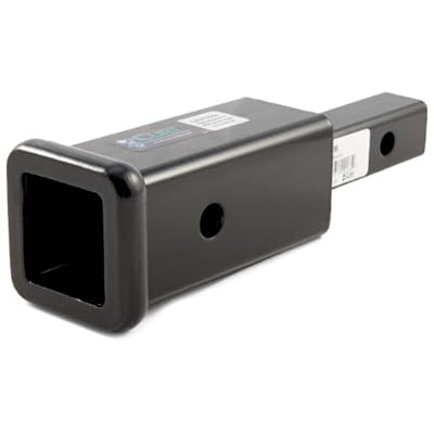

However my bike rack is for a 2" hitch. I looked at adapters but i learned that using an adapter cuts your tounge weight limit in half. so the 200lb limit is now at 100lb. Which is not good. Most likely will go see my brother in law again and have him cut off the end of mine and weld some 1.25" to the inside of it. Home made adapter.

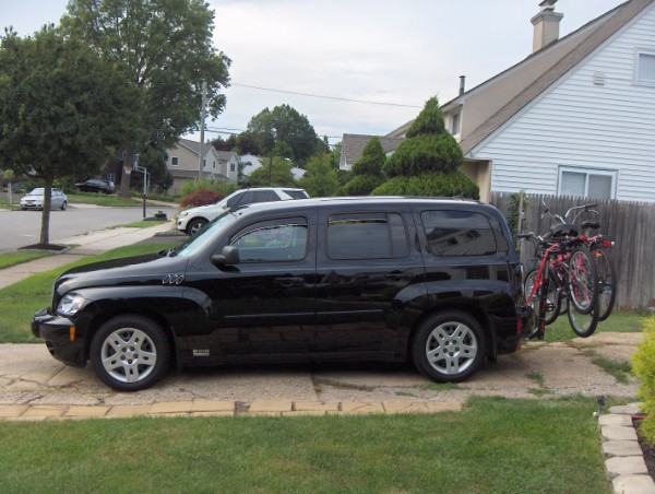

I haven't had any problems with my rack before. I've used it on a lot of different ones. Currently it will be used on my hybrid and my wife's comfort bike (hers has a frame tube adapter, so no worries on that one).
I plan on getting a new rack someday but it will have to wait. I want a good one if i buy a new one, and like the link you sent, they cost a good amount.
