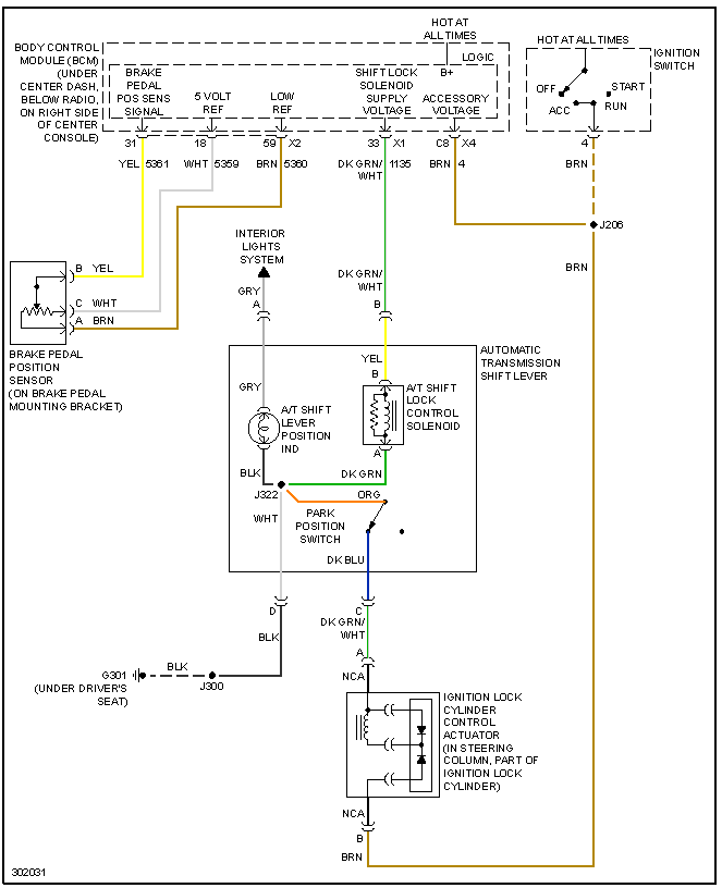

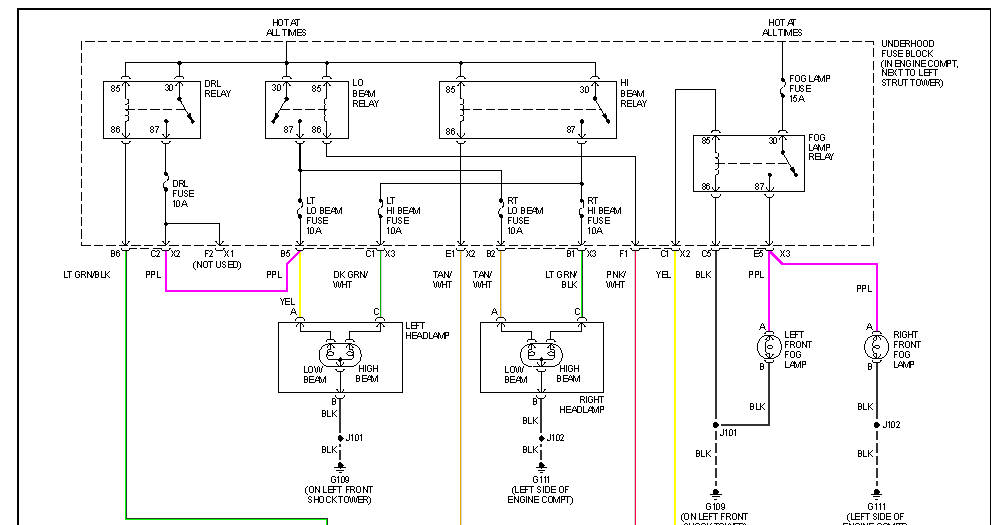

Probably wire into the DRL relay off the top of my head. I will think some more on it.

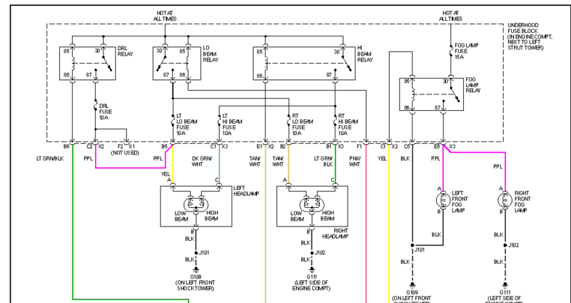

DRL

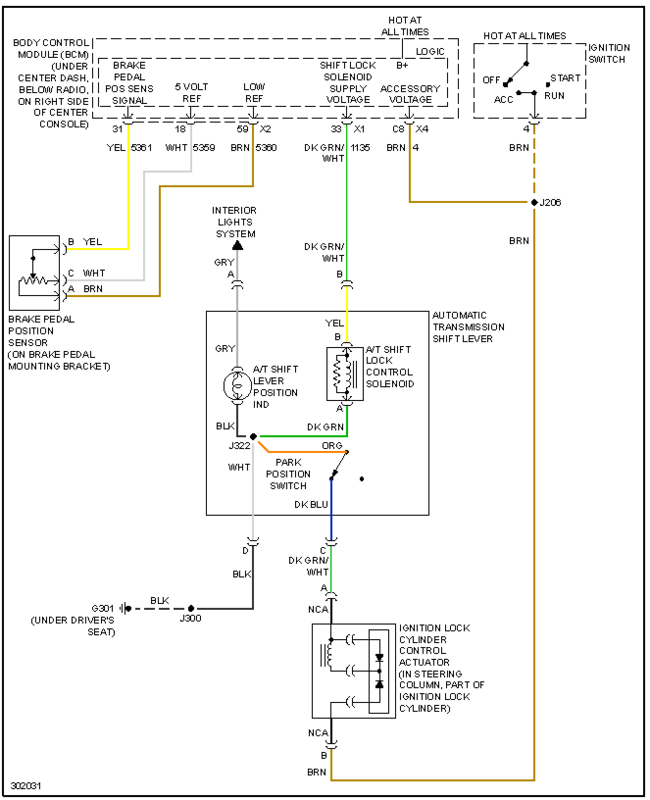

Park position switch

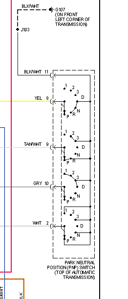

Or the PNP switch:

I think what I would do is put the + to the purple wire (terminal 87) of the DRL relay. It will supply 12V when the gear selector is not in park.
Or to the yellow wire going to the headlight. Whichever is easiest to get to. Maybe with a relay, but not required.
