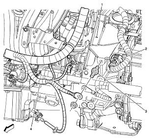

Does anyone have a picture of where that ground is located. I would like to check mine today , I have felt the shudder at a stoplight before. No stalling though..

Originally Posted by ChevyMgr
So the ground is listed as #3 in that diagram?
#3 is the stud that the wires ground to.
