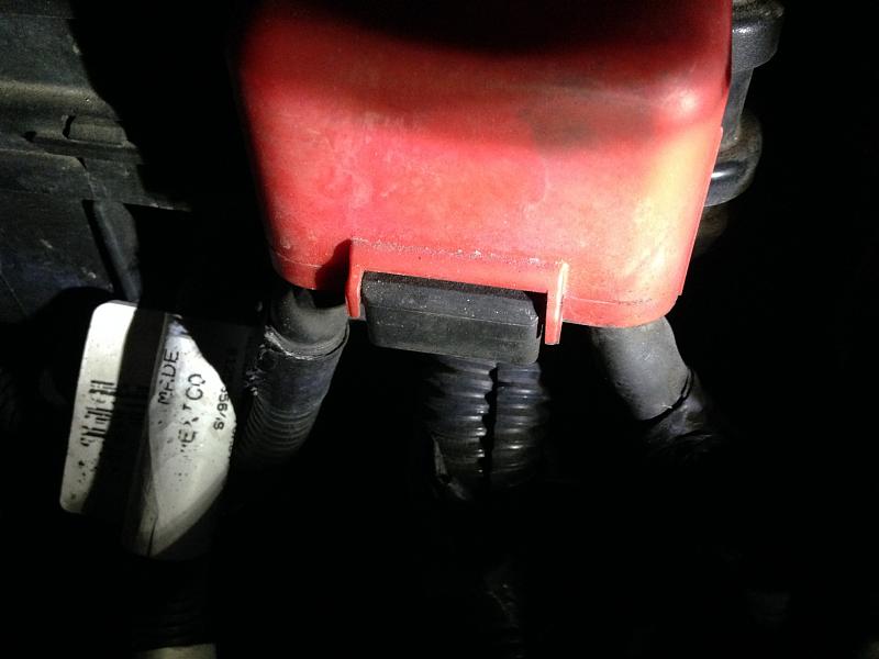

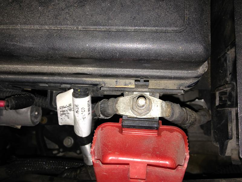

HI all, I've searched but not finding anything, I want to run a wire from motor home to battery to keep it charged while towing. the problem I have is what terminal on the fuse block is the correct one to connect to. they are both "Hot" owners manual said to connect to terminal with red cover. mine doesn't have a cover Thanks

This red cover

Thanks Oldblue, that is the post closest to front of car right?
Old Jun 12, 2016 | 10:00 AM
Posts: 40,083
Yes in the left of the fuse block! Front post
