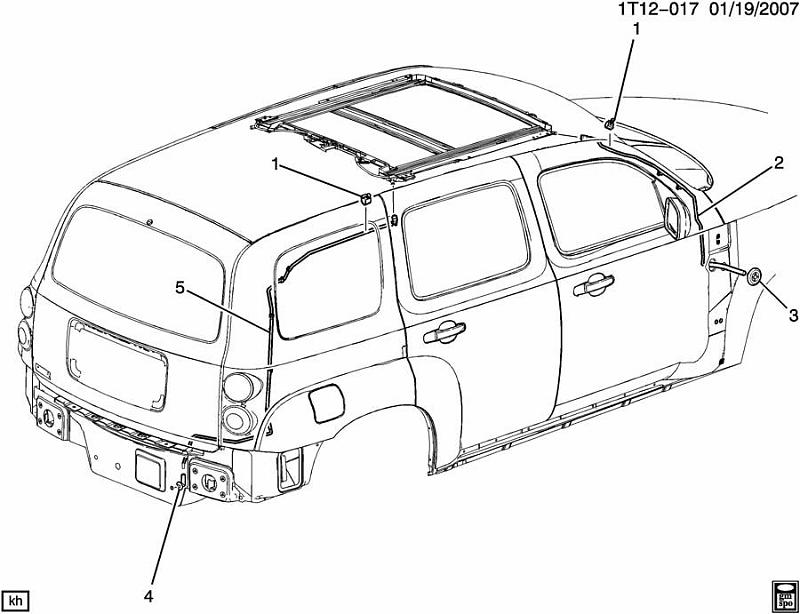

Sunroof drain pic below. Or as Donbrew said, could be the rear window washer tubing is cracked. I doubt it would be the hatch unless there is an obvious tear in the weatherstrip or the car has been wrecked.
edit: the picture only shows the right side drains. There are also left side drains.

But would the sunroof drains dump water into the cargo area, in a visible location? Unless there were a hole in the drain line itself, I would guess that the water would back up all the way to the sunroof? Is it a 1-piece hose or multiple pieces with couplers?
