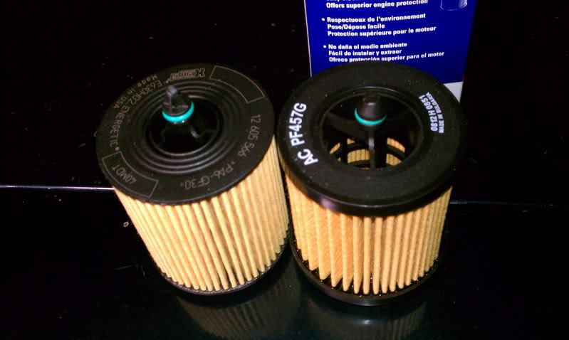

Ok. I bought a new AC Delco filter yesterday and when I got home and compared it to another AC Delco that I forgot I already had on reserve, I found two things to be oddly different.

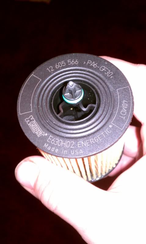

The new one is a "Hengst" filter...the other one simply says "AC Delco" on it.

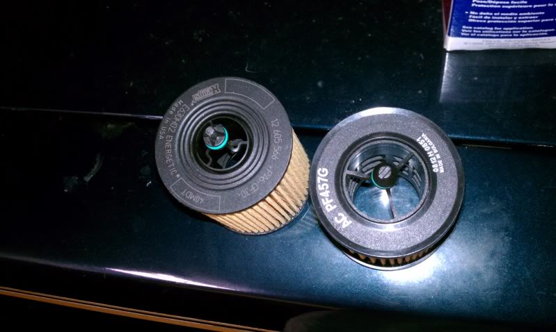

The black plastic caps that cap the filter pleats is thicker on my older filter as opposed to the Hengst AC. You can see what I mean here.
And finally, what really alarmed/confused me was the hole in the center. The Hengst, even though it appears to be built with more...care... has a MUCH smaller hole in the center. There must be a reason. More pressure maybe?
I'm not sure. One or the other MUST be better considering the differences.

I think I figured it out
The bypass is in the cap. They redesigned the caps to accommodate different bypass pressure.
Any one of us could be running a filter that inadvertently tosses the oil bypass loop open and the oil is no longer filtered. If you have an old style cap, you use the large diameter centered filter.
