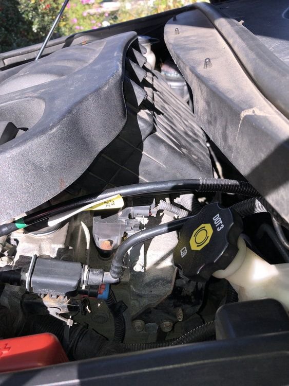

Hi Oldblue today I got the fuel line from the inline tube, easy the install, but is too long, I need only one of the evaporation lines because the other one from the injector to the fuel tank was installed before, the other owner maybe he did, but where can I cut ? I don't want to cut and regret it, so I prefer to find out before making any mistake, I cut the old line nylon and joint to the new line by the connector. thanks so much
Old Sep 12, 2023 | 07:41 AM
Posts: 40,068
I trimmed my vapour line at a straight line under the brake booster , however you can cut the line and connect it wherever it fits best
OEM vapour line back to the firewall
The connection in the straight area of the OEM line I trimmed the new line with a couple of inches slack
