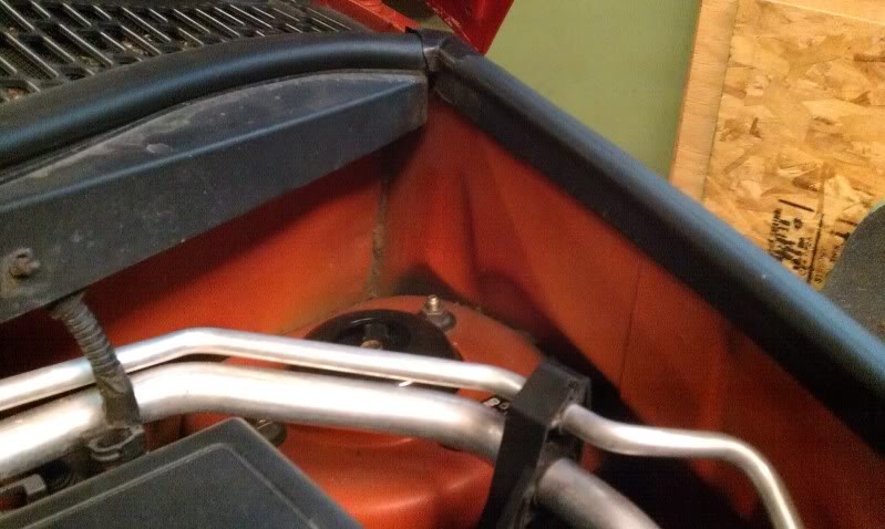

I manage a bodyshop and received a rather damaged '11 (automatic), in which the driver's side of the firewall has ripples. Our donor frontend has the same, to cure the owner's concern though I'd like to verify with some of you .
My '08 SS does not, but appears slightly different in that area as well.
So anybody care to pop the hood, examine the firewall behind the driver's side strut tower, please report! Thanks .

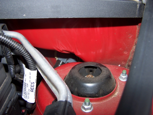

Here are a couple pics from my 2006. Hope this helps.

Mine looks much the same as post #3 pictures.

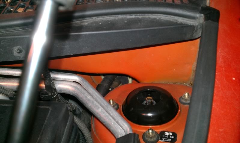

Just checked out my 2010 SS 5spd LSD/Brembo and it is indeed rippled. I have had the car since 3 miles on the odometer, no accidents. If you look close at the photo, you can see where I rubbed my finger through the dust across the ripples. They are very slight and maybe 1/32" in height. To me, they look like part of the forming process of the firewall when it was stamped.

My 2010 looks just like Sidecardog's (except mines red). Wrinkled. Feels worse than it looks. This appears to be normal on some.

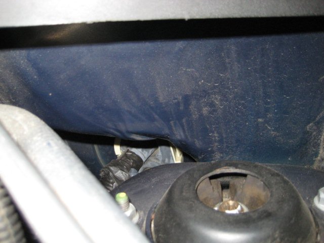

fwiw: I just checked & my '08 2LT has a very slightly rippled area there, can only feel it..To minimal to see.
I agree with Sidecardog, seems to be from the stamping process..
