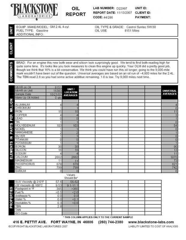

Here's a report from a 6 month, 8151 mile run on Castrol Syntec.
Engine had two oil changes with dino before switching to synthetic.
