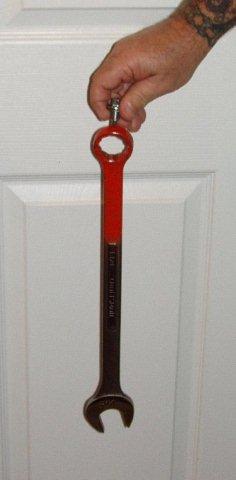

While on the oil subject, here's my magnetic drain plug. Yes it has some power..
Lil extra insurance, imo..
