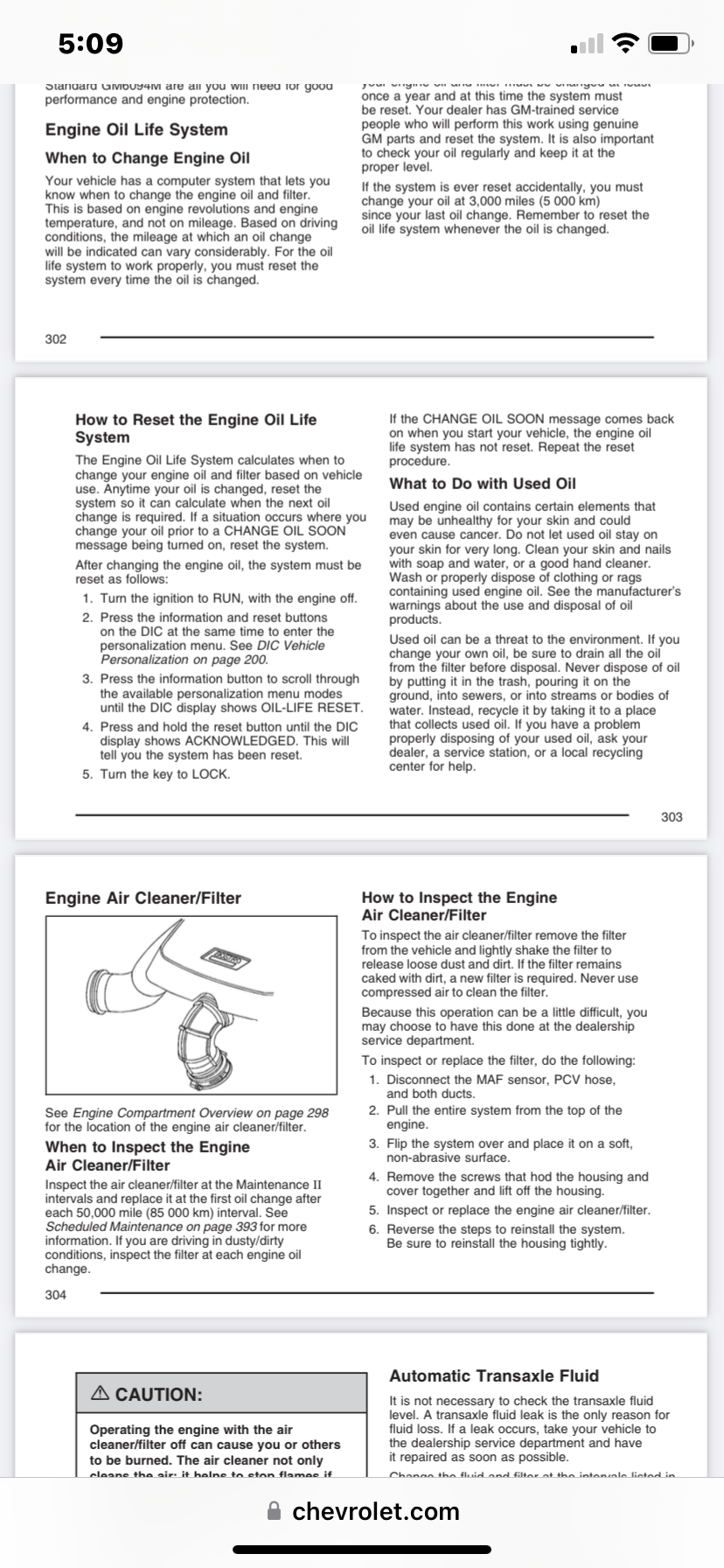

For fun, I looked up how to reset oil life on the 2006 model year in that owners manual in section 5 page 17
the 3 steps on the throttle pedal method is not mentioned
Old May 26, 2022 | 04:16 PM
Posts: 40,083
On page 303 of the 2007 model it’s not mentioned either
But I know I used the three press the throttle pedal method in Oldblue, every 10,000 kilometres, from 54,000 to 484,000 that’s 43 oil and filter changes! I wonder if someone with an ‘06 would try to reset with the three tap method?

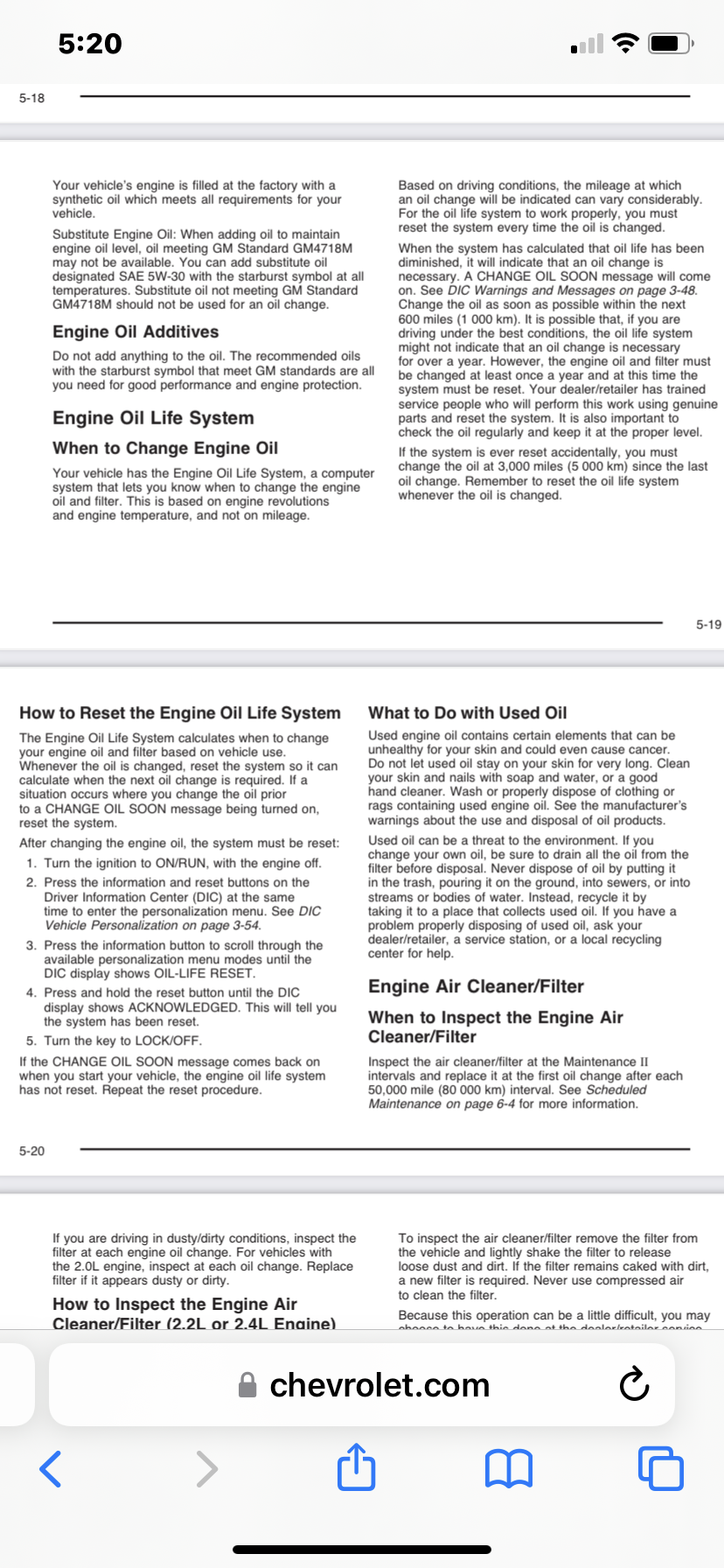

Page 5-20 for the 2008
