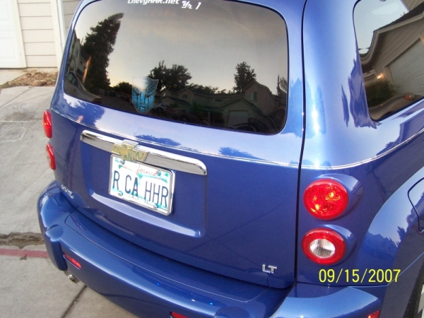

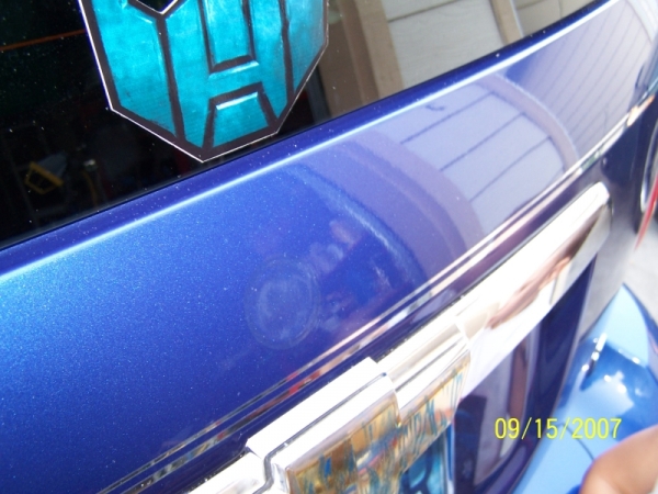

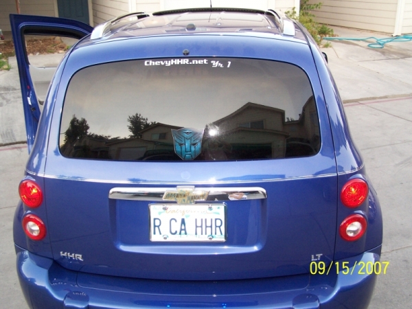

I did our about a year ago and I love the smooth look of the no rear wiper.
To fill the hole I taped off the hole from the inside and bondo'd it up, primered, and painted it with some touch up paint through my airbrush.
Heres the pics.

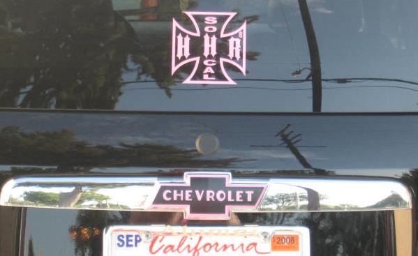

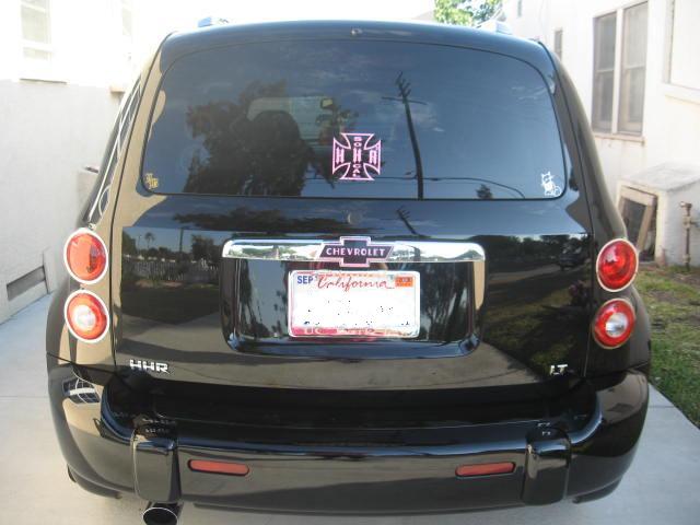

Blackie with the rear-wiper-delete.
Used a plastic plug (thnx, Don!) and silicon to glue it on.
