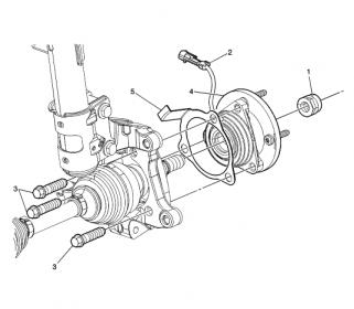

I remember your post. Sounds like you may be ready for new Hub(s), but I'd still check end-play at the hub. Should be less than .002
Yes you will see the "in & out" play in the axle if wheel bearing is bad..
The axle is held captive by the hub nut (see pic).
So if hub bearing has too much end-play & moves, the axle will follow, it's connected to it..
sleeper is offline
