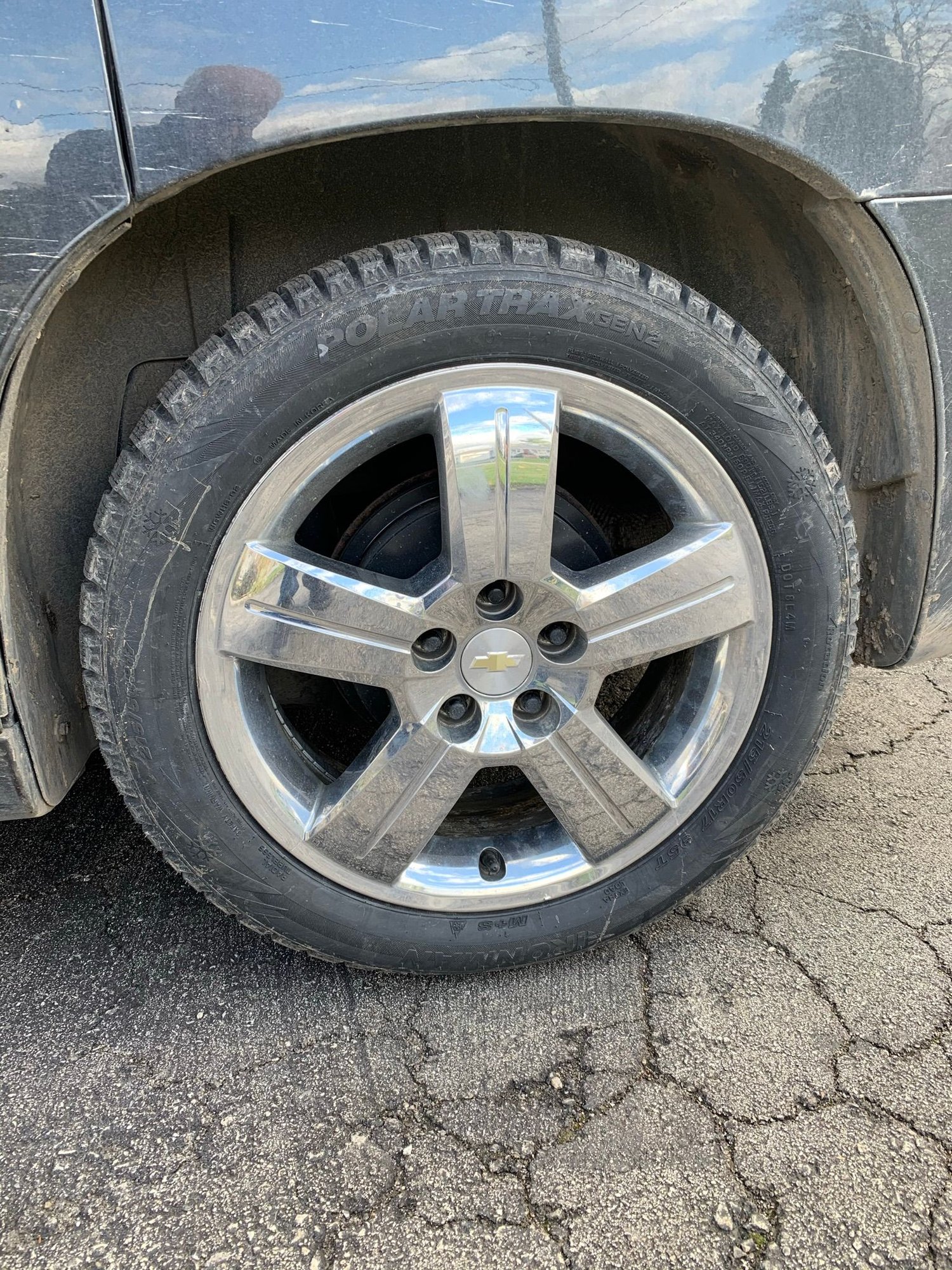

On other hand, if you have anything other than the stock 18-hole steel wheels, any disk in the rear will look a lot better than those microscopic drums, lol.

Third- The SS brakes are tiny. They look small behind even a 17" wheel. Definitely cooler than drums though.
