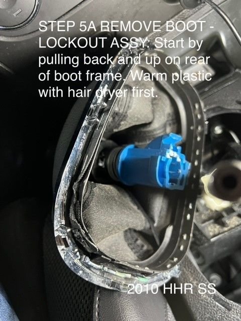

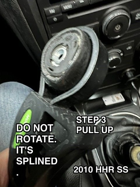

Removing HHR SS (2010) shift knob and boot
Hi Matz.... HERE US YOUR SOLUTION (SS SPECIFIC)
You've probably figured this by now. I need a shift cable adjustment... so I had to go thru this removal process. Here's what I learned...
First off, the SS boot, is different, as it the method of removal. The boot CANNOT be removed from the shifter by rotating it CCW 90 degree like some others. The boot is tightly held to the shifter's reverse lockout slide with a tie strap (on the inside of the boot). See pictures.below.
The second eye opener is that SS shift ball has a unique method to attach, You'll see from the pictures that I used a rubber oil wrench tool (Harbor Freight) to pull this SS OEM ball off (after removing the emblem cap and Torx 20 screw). I saw a You Tube video where a guy used a wheel puller. I didn't have one. You really have to pull! (it's pressed onto a splined shaft). But the rubber wrench worked.
You really gotta pull!
To get to shift cables... looks like more work to do.
