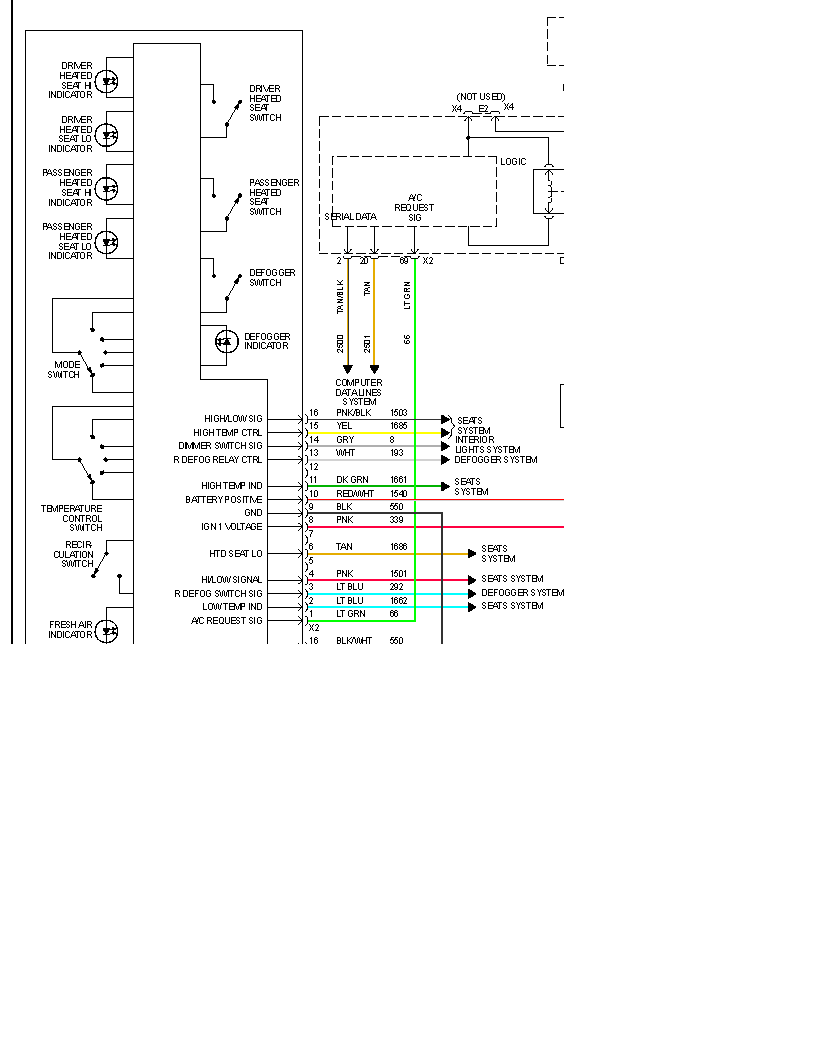

Here is the wiring at the BCM.

Thanks for that rollercoaster ride OB. At first I thought...I'm screwed, but the seats were only $150 and no biggie if the heaters go unused. Then I thought well the new panel is 2LT...yes. but they have cloth seats that never have heaters...back to no go.
Now it sounds like its 50/50 with being pre wired. Guess I'll find out at the install. I'm hedging that wires are already there. Thanks again OB.

You could stick your hand under the seat and check for a vacant pigtail. You should be able to see if you pull the seat all the way up.

Def gonna check that. Im hoping all 2lt s were wired for it but only used if built with leather.
