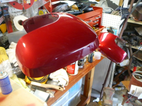

I just painted my mirrors with the spray paint I got from GM, I wet sanded with 800 grit sandpaper, 2 wiped it down with pre prep and 2 coats of adhesive promoter, 3 coats of sport Red metallic and 2 coats of clear and the paint looks as good as the original paint. It was easy just put thin coats on and then one wet coat.

Thats Sweet. Awesome job oldscout
