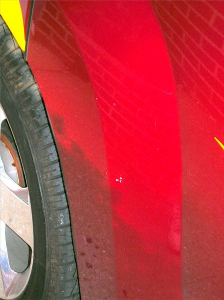

[IMG][/IMG]
Here is the dent-it actually is not as bad as I originally thought it was.
