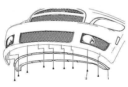

Does anyone know how the extension attaches? is it push tab things or screws?
Old Aug 27, 2014 | 09:32 PM
Posts: 11,719
Screws and push pins.
Your picture shows the screw locations. There are plastic trim pins on the ends.

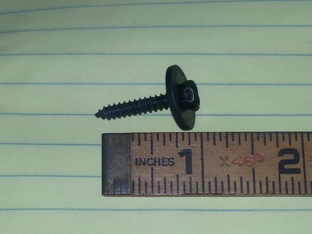

Here's a picture of one of the screws. If I remember correctly, it screws into a metal screw/clip at each hole. You would need the matching clips for each hole. And,No, you can't swap it with a nut and bolt because you can't get a wrench on the top side where the clips are.
*that's a 7mm nut head on the screw.
I'm sure you could get these at any auto parts or even the hardware store.

called the dealer and they want $6 a screw! haha ya ooooook!
ill check out the parts stores around me as suggested..in case anyone is wondering the sizing is metric 4.2 x 1.41

That size screw is only going to work if you're using it with the corresponding same threaded clip.
