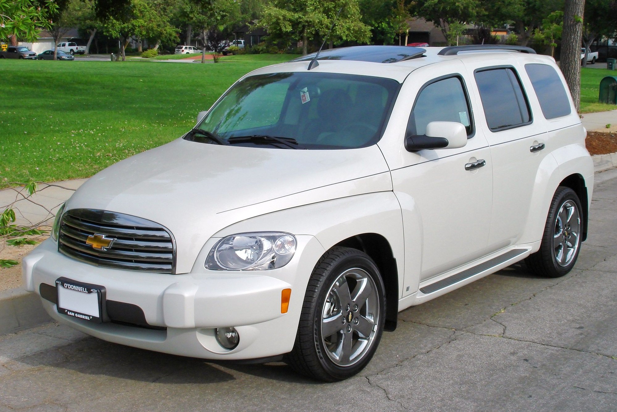

Just bought my 2009 LS 7 weeks ago, enjoying it for the most part. Bought it to replace my old DD, as I don't like driving my 2008 Challenger SRT everyday. Yesterday I found out if you have the sunroof open in vent position, it closes after you shut the car off. Is there any way to keep it 'vented' when parked?

Are you sure this is a factory sunroof ? May be aftermarket. Since yours is a basic LS model, a lot of those didn't come with a factory sunroof.

I have the owner's manual, doesn't say anything about it. Yes I'm sure it came with the sunroof I have the window sticker as well. If I open the sunroof all the way it will stay open, but when just the vent is open it closes about 10 seconds after shutting off the car

There is something about your sunroof, it doesn’t appear to be factory
The edge around the glass doesn’t appear to be like this 2007

I don't recall factory installed sunroof for LS, possible it is "Dealer installed"? There is only a tiny difference between LS and stripped LT, that is mostly the wheels and pin striping and LT had a choice of engines.

I thought I had read either on the window sticker or in the list of RPO codes that it had the factory sunroof, but that doesn't appear to be the case. It has the factory switch in the factory place on the roof, so I'm guessing it was installed by the dealer. Guess that's why it closes with the key off. Not sure how it's wired differently from factory to do that.
