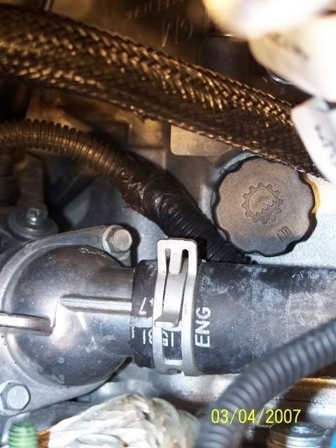

Does anyone know what the wiring loom with a green wire is inside the transmission fill housing? i thought i broke a peice of loom on accident while i was changing my fluid and it fell in but after looking at it with a flash light i can see it looks like it's supposed to be there i took my finger n stuck it in the fill hole as far as i could it seems to run all the way inside the trans

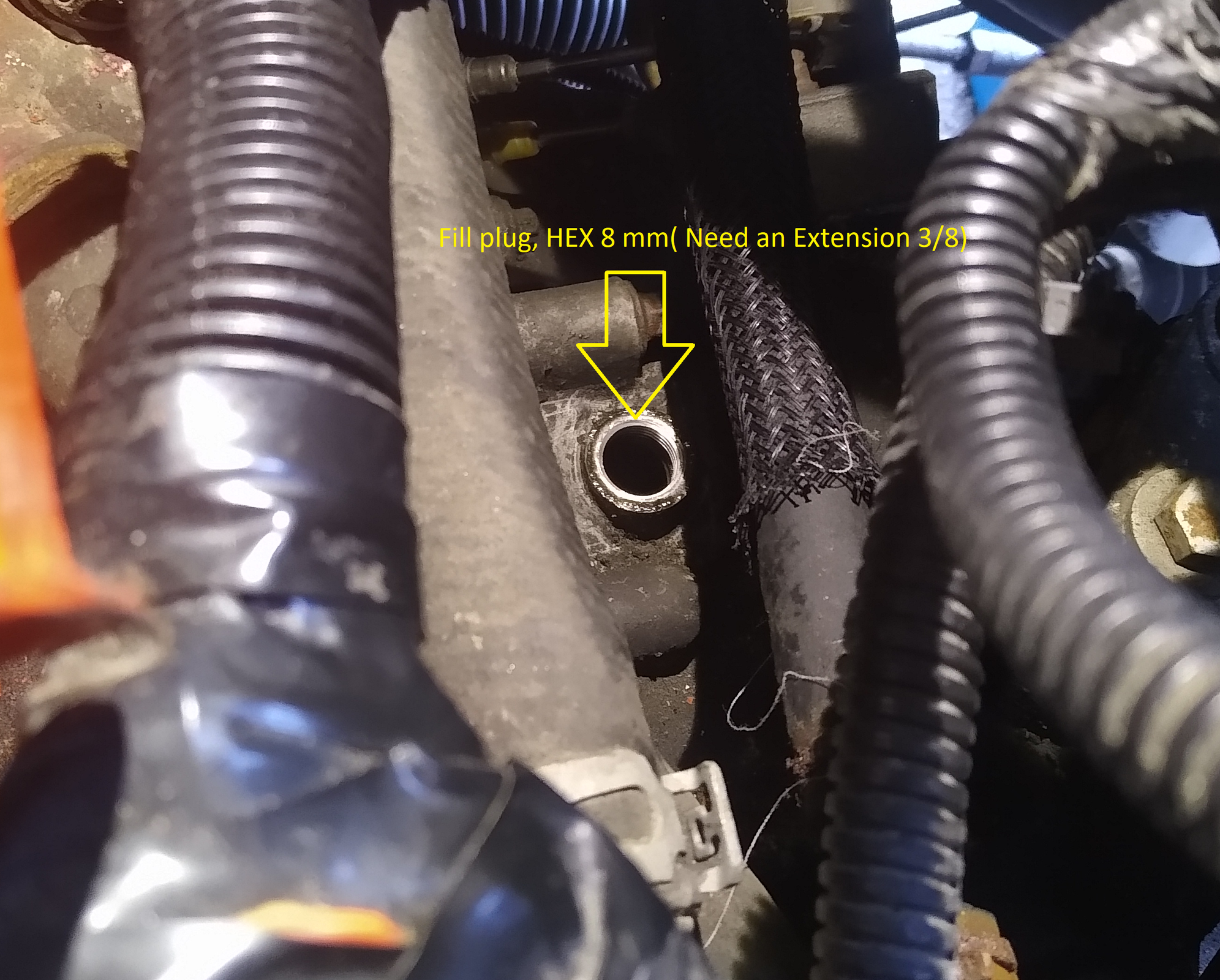

If you look into the transmission fill port on the right side of the motor would this harness be in there?
I just want to make sure i didnt actually drop anything in there via it be a a broken peice of loom or a crusty wire that broke off with the loom also it seems weird that there is a loom with a wire where you put transmission fluid?
Old Jul 16, 2025 | 04:59 PM
Posts: 40,083
No wires are located that area, just looms that run by there
There the fill port , no wires in that area

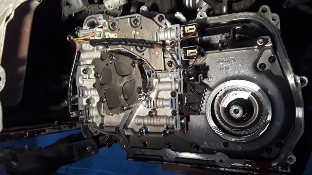

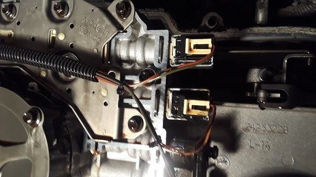

Old Jul 17, 2025 | 08:26 AM
Posts: 26,532
However, inside there are wires going to the solenoids. One of those is LT-GRN for the 1-2 solenoid.

Posts: 40,083
The harness energizes the shift solenoids and TCC valve internally to the transmission
