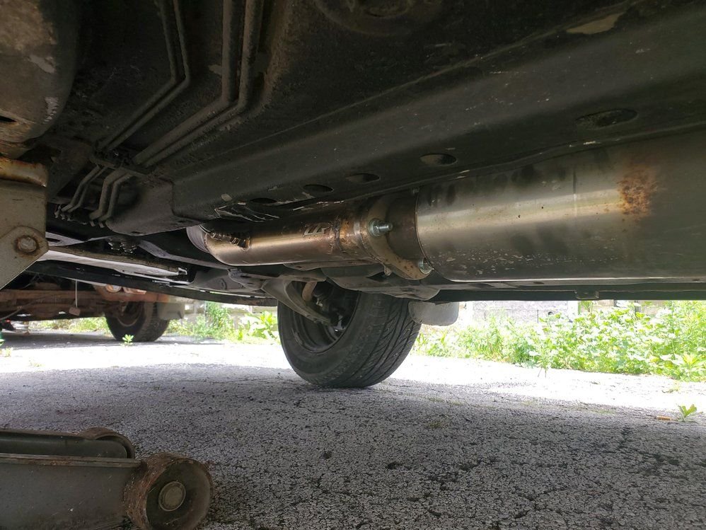

Did you look at the photo of where his weld is?
Yes I did.
So where is the leak you're looking at ?

OP has not posted a photo of where the leak is. He described it being at the weld of the downpipe-to-flange.

It’s some where in the weld from the down pipe to the 3 bolt flange in this photo

Oh, ok. So it is on a straight pipe. That's pretty ugly.
They should have welded a 2-bolt flange onto the resonator. If you have to replace the downpipe in the future, you'll have to pay a welder again. Or buy a correct resonator.

And im Back.... Ok, he needs the Downpipe to come off of the car, going to cut the weld, clean it up and reweld it correctly. While looking at it, we both noticed, that gasket that goes from headers to downpipe is bad, frayed at one of the bolts, just flapping in the wind lol..
So this week on my day off, im gonna take off downpipe, hes gonna reweld it and ill put on new gasket.. so ill have a update this week hopefully.
