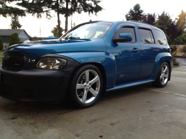

here is one with 255x40's on it.
Thanks I feel like if I were to get anything bigger than 255 it would stick outside the fender and look bad
Old Aug 11, 2014 | 09:11 PM
Frenchy42's Avatar
Joined: 12-06-2013
Posts: 540
From: Everett, Wa
I recommend keeping with the 18's. I have 245/40 18's and they don't have a ton of sidewall(If that's what you're going for), but enough to save me from potholes and such. SS Fan, at one point in time, had (correct me if I'm wrong here) 255/40 18 with little to no rubbing. As Fireman said, the max for the SS is about 26.3", 245/45/ 20 would put you at 28.7".
How wide were his rims? Cause I am having a little trouble finding 255s for 7.5 rims which are stock right?
Old Aug 11, 2014 | 09:47 PM
Frenchy42's Avatar
Joined: 12-06-2013
Posts: 540
From: Everett, Wa
The ones in the pic he posted, Factory Pontiac Solstice wheels. 8in wide.
