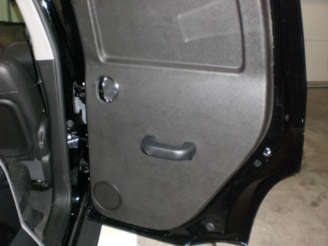

Mine has interior door handles, they work as they should also. I called the dealership yesterday and you know I will never get that 20 min back. Total waste of my time. If its fixed I will half to pay. They are not going to make it right. It was even checked off on the GM Certified checklist that was in the car. I wonder what else they didn't check???

my '08 has interior rear handles,too

mine looks like that except for the lower armrest pulls, they look good.
My bad, for some reason I was thinking rear Door Lock knobs.. Doh !!! (brain fart).
Yes I have interior rear handles also..
