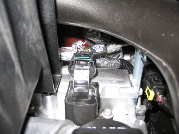

Originally Posted by pg318
Some, including MSD, have pickups that clip over the coil wires, so they'll work with just about anything (though probably not the L61 cassette).
Here is the MSD unit installed. Works great, i am using ot with a Summit Racing shift light since I already have one. This MSD pickup allows you to use any shift light, but since you are just picking up one cylinder, you need to set your light for 1 cylinder operation, or for 4 cylinder operation divide by 4 (setting of 1500 rpm = 6000 engine rpm). If you can only do 4 cyl setting, you are likely stuck with 400 rpm increments of adjustment though. The other options suggested in this thread look pretty good too. The second photo shows where I installed my light. If you do something similar, note that the clearance is tight, so it pretty well has to located EXACTLY where I put it to clear the "glovebox" and other internal dash pieces, so be careful when boring the hole. A better option might be a single bright LED in a bezel. (BTW Because of the photo distortion, it looks crooked, but it is not, it comes out perfectly straight).
