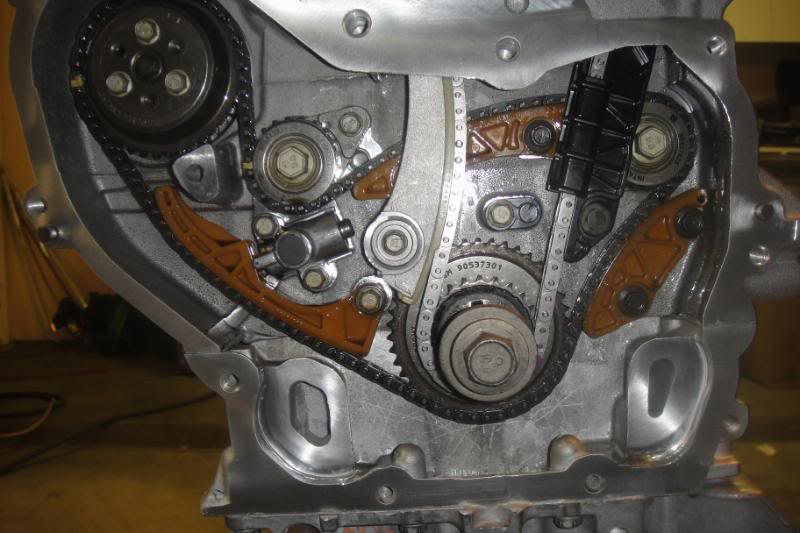

there are 2 timing chains. double-check that BOTH were addressed.

Actually one is the timing chain the other is the waterpump and balance shafts chain, they should be changed at the same time, hey you have it apart and are all greasy anyways, type of thingy.
