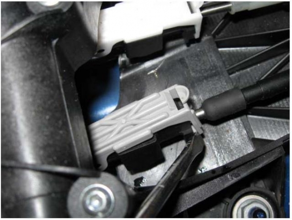

1. While prying ever so gently on the shifter cable clip, the gray part that locks the cable in place broke (see image from instruction sheet below). Without this part able to be locked down, the entire shifter mechanism is useless (as in, you cannot operate the car!). I currently have a cable tie wrapped around the piece, which locks it in place. It's probably as strong as the GM part that broke. GM did a crappy "let's save $1.87" job on this design... TWM should design and offer something that replaces everything from the short shifter's lower pivot ball, all the way to the cable end.

Personally, I am very happy with the quality and performance of my TWM setup. It was a bit pricey, but I think that the market is fairly small and the compensation for R&D and skilled labor is fair IMHO. As far as your clip breaking, I have had mine uncoupled at least 5 times dialing in the adjustment when I first installed the shifter, so I bet yours was damaged or faulty as delivered from Chevy. As far as the aluminum vs black looking "hideous" looks fine to me, but certainly we all have different tastes. Photo below since you did not have one. Good luck with your repair, and once you drive with it a while I bet your satisfaction improves.
