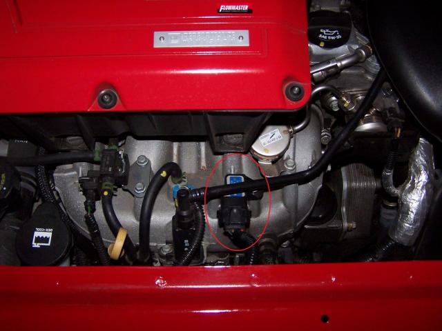

Here is a link to a pic of the upper TMAP sensor, with the blue bosch label. This engine has the GMTU. As I understand it though, it may be difficult to find a dealer to do it anymore, as it is so old.
https://www.chevyhhr.net/forums/atta...sch-sensor.jpg
There is no way for us to know if the engine in the car you're looking at can handle it. You would need to have it gone over with a mechanic knowledgeable about turbocharged ecotec engines.

Here’s that picture
