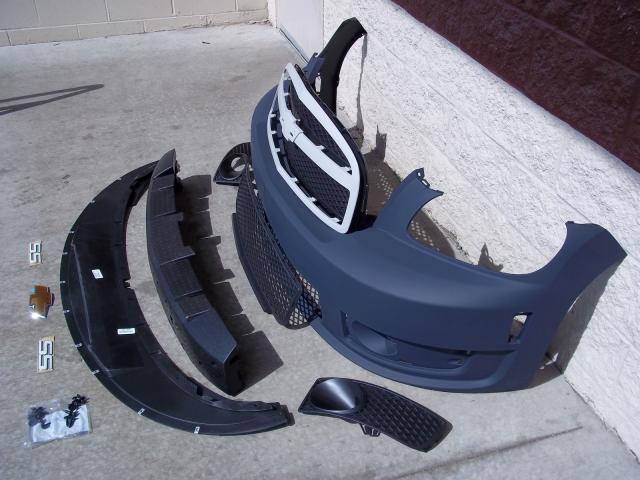

This is the stuff you will need to install a ss front end. Got every thing from Rock auto.com

Posts: 40,083
That's the kit ! Just paint and install!

Posts: 11,721
Well. It's a little bit more than a kit.
I see RF2 has 2 side SS emblems there. I guess he's gonna make some kind of a clone or something.

You will need the running lights, electric adapters( pig tails are different for running lights) a heat gun, all the parts will have to be fit to your car. A six pack helps. It does fit.
I gave them away, I don't advertise what is inside. This one will just be supercharged
