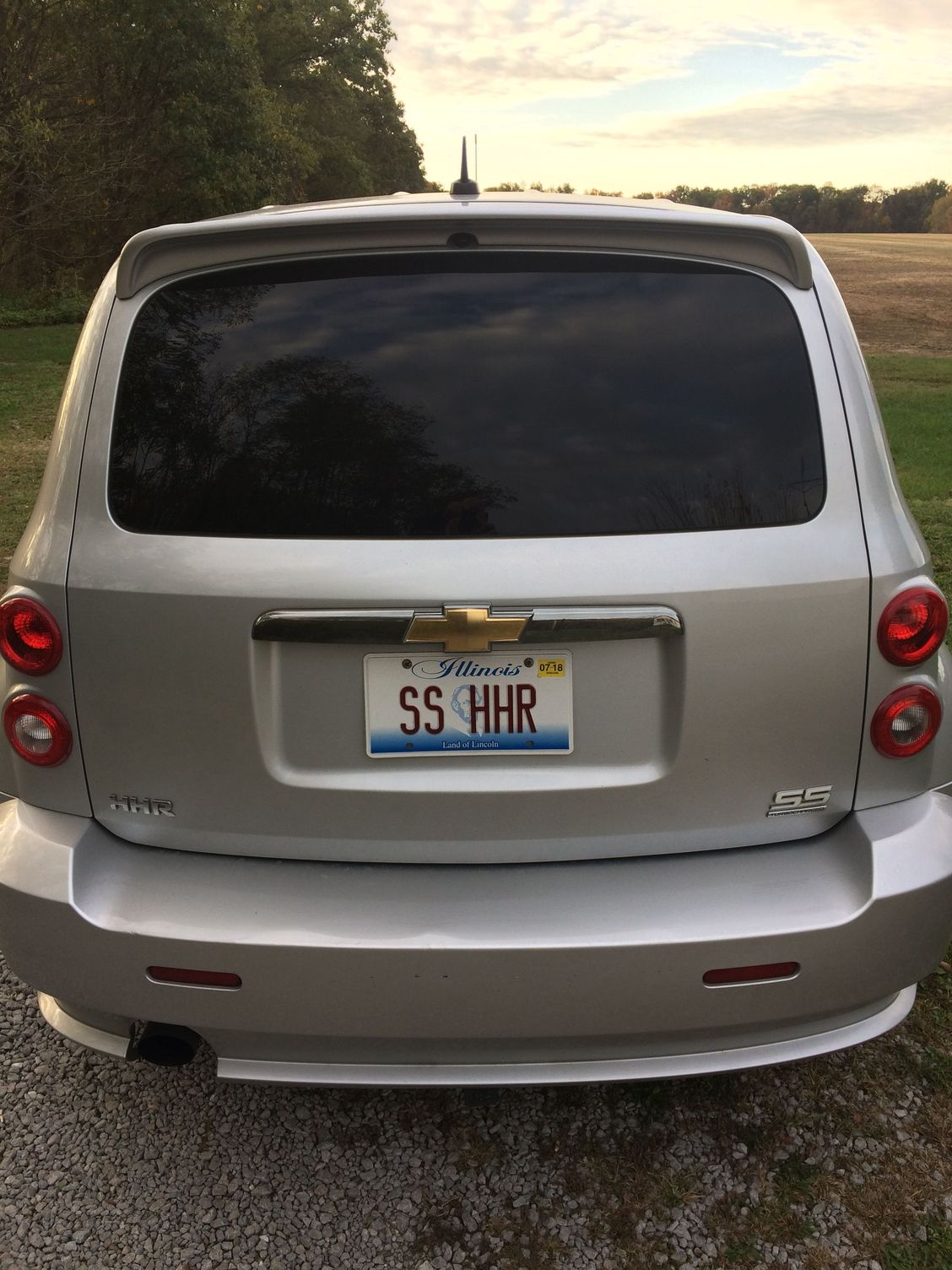

jojothetattooboy Nov 20, 2017 06:41 PM
https://cimg1.ibsrv.net/gimg/www.che...021d796cdd.jpg
Originally Posted by firemangeorge (Post 832087)
Honestly. Since they are almost impossible to find (and always have been), I doubt that anyone has a spare "new in box" one in their parts collection.
Just a heads up if you don't get any responses to your question.
I just noticed we have the same plate!

Hmm. Is that a chrome beauty bar I see ?

And FMG - you are right, that dark chrome liftgate handle isn't your color - pink would work however. ;)
