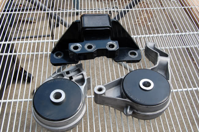

I'll be installing them in my plain jane 2LT Automatic.

so its not really solid but just firmer? i am getting a lot of wheel hop and need something to cut it down a bit
It will cut it down a lot, if not all :)
Solid is a term that can be used here, as the stock is floppy! Solid does not mean metal on metal, it means rigid, or firm, or little to no movement.
