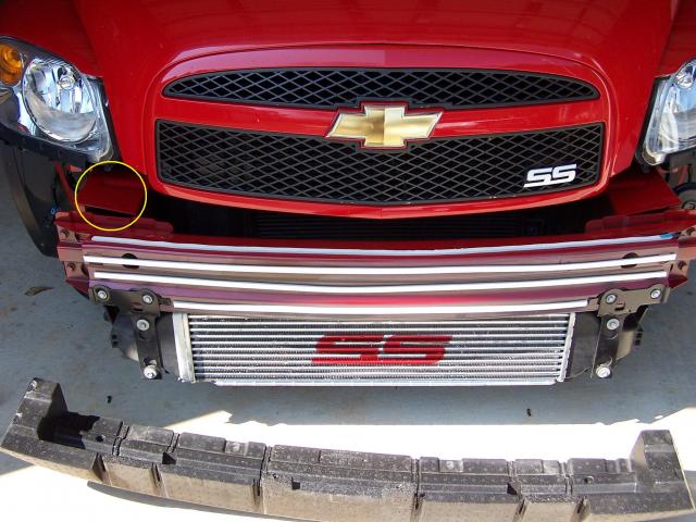

Donbrew. The intercooler on the SS sits way down low. Under the metal bumper.
Name:  SS bumper.jpg
