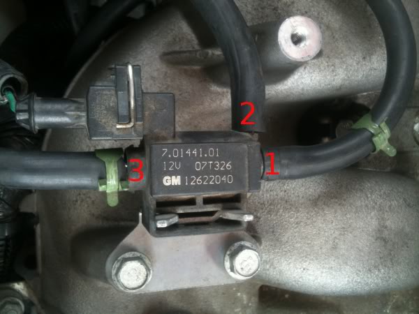

can someone tell me where each hose goes
[IMG][/IMG]

which angle is the pic taken at??? One goes to the BPV, another goes to the cold side pipe and the third i forgot. If you tell me which way the pic is taken ill tell you 2 of the 3

the clamp that is on is on bottom rotate counter clock 90

in that case the top one goes to the stock bpv and let me get back to you in a few on the other 2 im drawing a blank on which one goes to the coldside and i was just messing with it yesterday

not to sound dumb but 5 monthes ago we took out the motor what is a stock bpv i did a turbo swap with a pte 55/57 so if u can tell me port ? goes to bov port ? goes to cold side and port ? goes to ???

The top hose call it port 1 in your case since youre swapped should go to the BOV. port 2 will be the one to the left and port 3 will be the bottom one

1 - LICP
2 - BPV/BOV
3 - vacuum tank then intake manifold

Youre the **** Kendall. Thanks

**** so i was wrong either way. OOPS my bad
