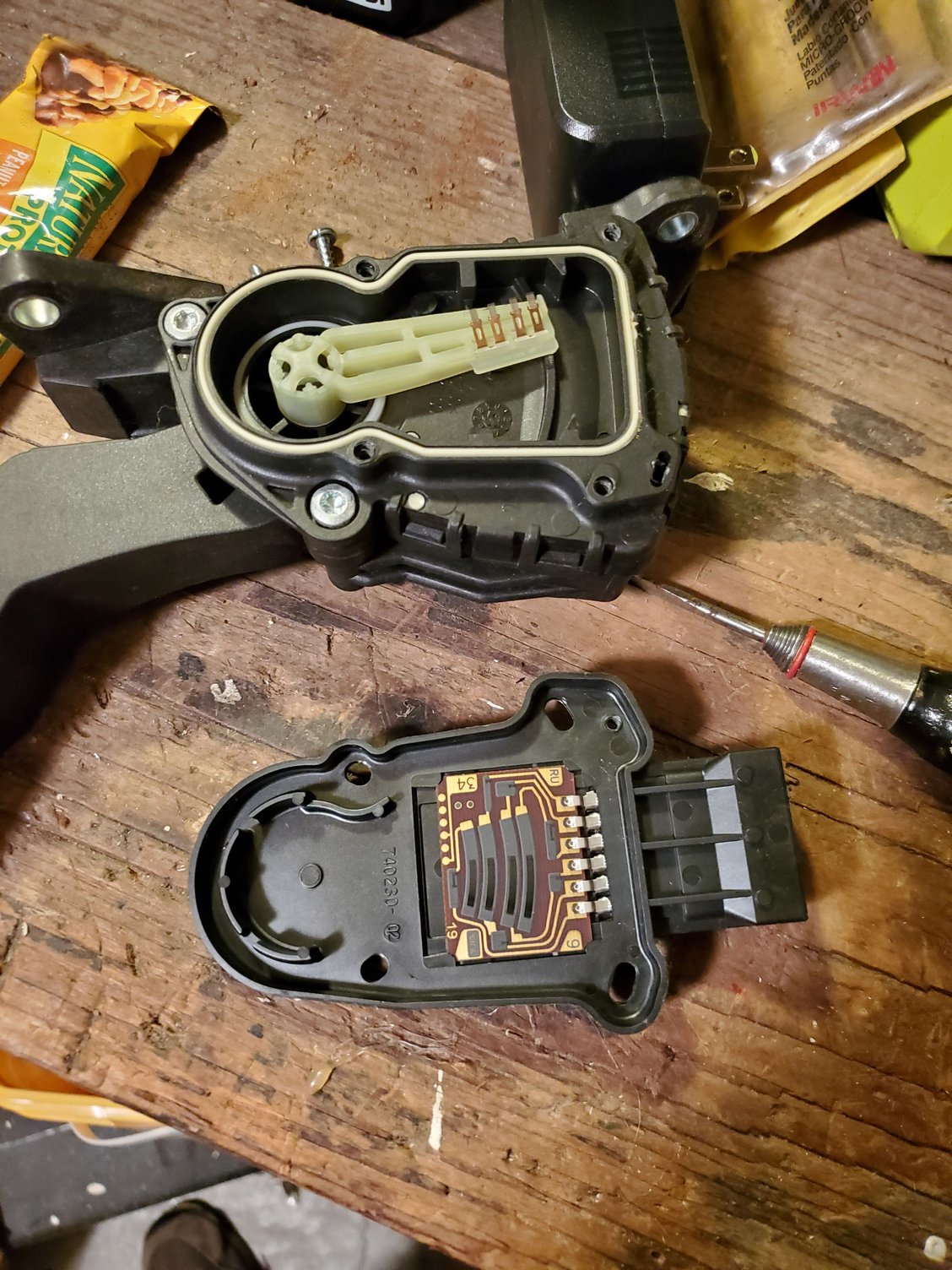

I appears that this issue has been corrected and it was the sensors at the gas pedal (accelerator). Repaired it at $0 cost.
I kept fishing around the internet for issues similar to mine for HHRs but then widened it to other Chevy products. I found a video on someone repairing 2008 Impala that had a similar issue with partial power at various intervals which driving. They replaced the entire gas pedal part. But before I did that I figured let me just take it apart and see what we got. The side of the pedal unit has 5 screws which allows you to open it up. There were 4 contacts which were very dirty and only need to be cleaned up. I used a pencil eraser cleaned them up and then used very fine sand paper to just slightly rub on the bushings which rub on the contacts. Put it all back together and after a week of driving, no issues.
