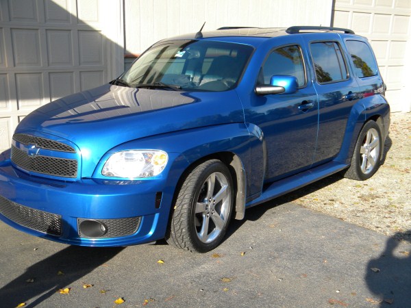

I have noticed the tires make a big difference in the ride, found a good one here, does every thing well especially a nice smooth ride.
