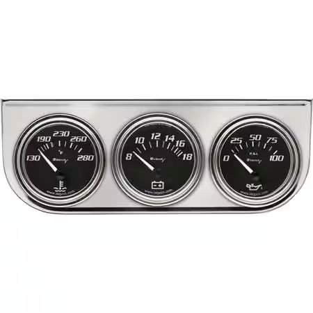

Oil leaking in the interior was always my pet peeve with aftermarket oil pressure gauges, yuck!
I was never thrilled when my service manager handed me a set of these to install in some kids used Camaro or Rustang! Most times the gauges and labour to install cost more then they paid for the car! I always would remove these from any used car I purchased.
I used those in several of ,my old rods.... never had an issue with them leaking? A friend Did have one where the plastic oil line melted on the exhaust manifold....that was a mess
