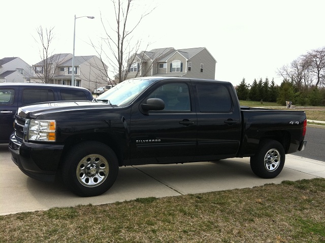

And they gave me an Enterprise rental car... GM will only pay for a GM vehicle rental on a warranty job.. The only GM vehicle they had on the lot was this gas guzzling beast:
Update, they fixed the leaking stuff, but still were not able to get it to run right. They said they ordered a new Mass Air Flow sensor and it should be in tomorrow. This truck is killing me with the gas!
