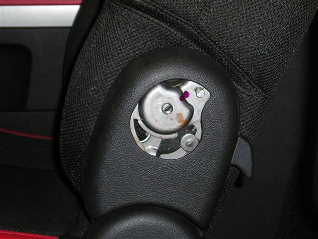

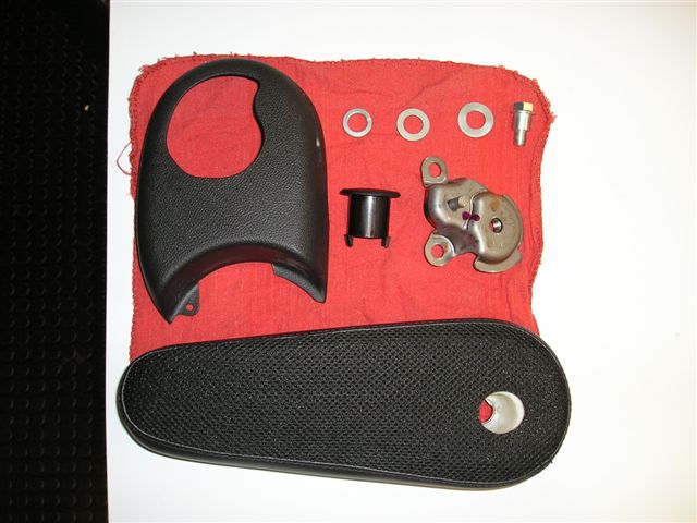

Hello Everyone This Is My First Post So Here It Goes!
2008 HHR SS Black/Red Interior, Stick And Fully Loaded W/ Performance Seat.
Mods: Tinted Windows/ Red "ss" Badges, Blacked Out Bow Ties And 2 Ten Inch Subs In The Back. Oh Alost Forgot I Added A Factory Arm Rest On The Passenger Seat. Here Are The Pics And Gm Part#s. I Ordered A Arm Rest For An Auto Ss Passenger Seat And It Bolted Right On.
I Love My New SS!!!!!!!!
Jeff
Retail And Employee Price 10% Over Cost.
1 15281816 Cover 18.53 13.00
1 15282009 F-cap 16.23 12.00
1 11561961 Bolt 5.19 3.00
1 25872601 Armrest 53.51 35.00
1 21993773 F-plate 20.87 14.00
1 21993772 F-plate 21.51 15.00
1 22732967 Bracket 15.14 10.00
1 21993800 F-spacer 77.01 48.00

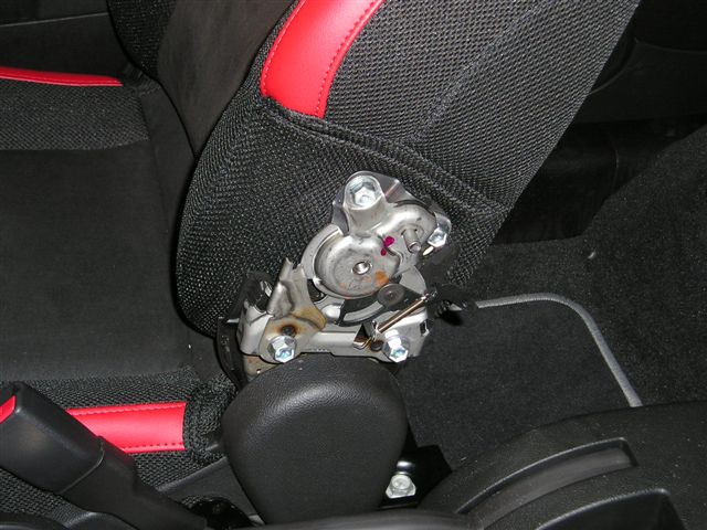

below are pics of my SS and all parts needed for the arm rest mod.
If anyone has questions please let me know.

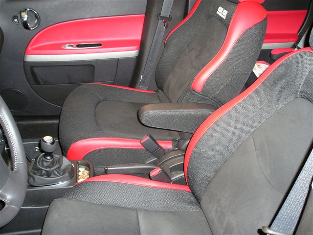

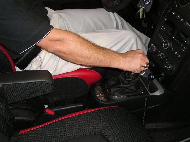

HERE ARE SOME MORE PICS! ENJOY
