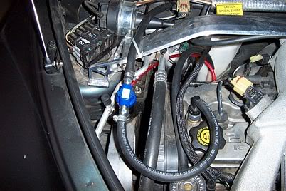

It's normal. We have the same thing in the PT turbo and the Neon SRT-4. We install a catch can between the pcv valve and the intake manifold. I have a Greddy catch can and empty it every 6k or so. You'd be surprised how much oil gets trapped in the catch can. This is a catch can on my '03 PT GT. It's the round blue thing in the middle of the pic. This catch can is actually used with compressor air lines to trap moisture in the lines. It is around $15 at Walmart.

This is a web page of the Greddy catch can that I have though mine is a little different cause it's older.
http://www.optionimports.com/oilcatchcan.html

Keep the intake manifold, intercooler hose and intercooler gunk free. I've seen several ounces of oil come out of a intercooler hose

Can anyone explain where to hook it up? Did you simply cut the line from the PVC valve (I assume we have one of those?) and put the can in line?

Inline. I've used both the moisture separator and the regular catch can. You have to empty the separator more often. I had to use this on my PT GT because there was absolutely no room for the Greddy catch can. I'm using the catch can on my Neon SRT-4 because I have the room and I don't have to empty it nearly as often.
