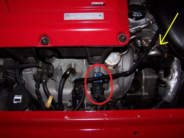

Oh..... also, Is the water pump on the SS in the same place as the 2.4? If yes-where is your second fuel pump located?
The New ATS 2.0 turbo motor has the High pressure fuel pump in the place of the water pump. I know ..... it is a whole different animal.
High pressure fuel pump is just above the oil cooler. (yellow arrow )
