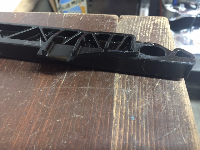

So I am now cleaning up from the project and sorting the old parts to see what I am going to throw away and what I am going to keep and I noticed something. The long black guide has a piece broken off it. I suppose the piece that is missing is setting in the bottom of the oil pan. It would likely be prudent to take the pan off and fish that piece out. Oh well, another project. I think that it is big enough that it won't really go anywhere but better safe than sorry.
Old Apr 12, 2017 | 02:01 PM
Posts: 40,096
You should be fine, it's big enough to stay in the pan plus it's plastic!
