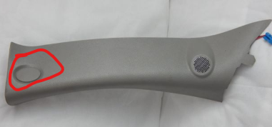

What would the differences be between an A-Pillar moulding that is made for HHRs with airbags and a moulding for HHRs without airbags? Part number 25799243 is apparently the same as 25799244 but its for HHRs that do not have side airbags.... Apparently. Would they look or install any differently?

As far as I know just the "airbag" written on the plug.

Maybe this will explain why im asking.

So the only diffrence would be the oval piece that says airbag??

The bag itself lives under the headliner. IIRC, the bag ties down on that bolt. Nothing else but maybe a wire under the trim.

Well the part 25799243 is explained as the A-pillar with the boost guage but for the Canadian model and without side so im wondering if its going to mess up my side airbags as i do have them... I think lol... It says it at the top of the pillar anyways.... Personally i dont care im still gonna use the pillar anyways i just dont want any fitment problems when it gets here if i habe airbags and this.part is meant for hhrs without them.
