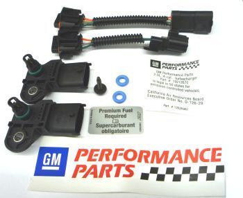

Old Mar 10, 2020 | 05:01 PM
Posts: 40,096
They never do! What else is new, just prior to the tune? Stage 1 GM sensors?
any possibility of loose clamps? Or cracked pipes or tanks on the inter cooler
