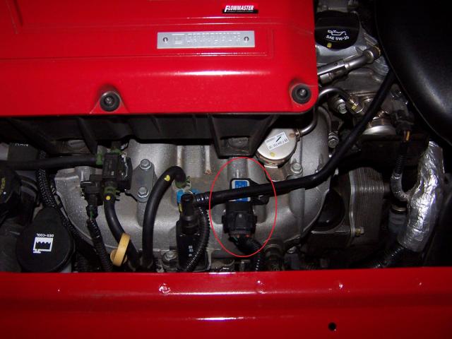

Is there any easy was to tell if it's had the GMTU installed? Are the sensors marked 3 bar?

The GMTU SS's will have this Bosch Tmap sensor on top. The blue sticker is the giveaway that the car has the upgrade. There is also one on bottom that is not really visible.
The stock sensors are just plain black colored with a small white GM logo..
