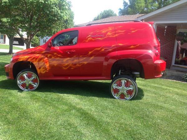

Okie dokie! Maybe those 2 “ strut spacers up front. This guy lifted his Corolla
Im not endorsing this idea just sharing the information
