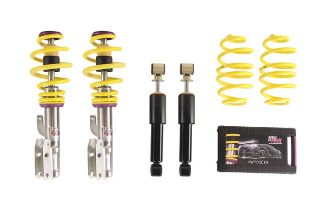

Sorry, it is a KW Suspension coilover. Here is a picture. I will contact KV Suspension. It'll be a while, they are in Germany.
It is the Kit V2. Part #: 15261005.
