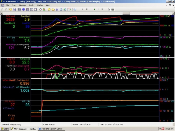

Brake-Boosting
, at the line, is so sweet…Here's a 1/4 mile run, highlighting, with that vertical straight white line, 5.9lbs of boost, at the line, at 2,629 RPM
If you follow the top red, RPM line, of the graph, you will see the 2 shifts, into 2nd, then 3rd.
If you follow the top green MPH line, you will see, a smooth increase, with no wheelspin.
The most important line on this graph, is the straight, wideband , (WB B1), baby blue in color...
You can also see, at the bottom, 100% throttle, by me, & the ECM, sometimes, if the ECM, doesn't like what it sees,
or the slicks break loose, the ECM, WILL, throttle back, even with your foot, petal-to-the-metal...
This chart , I believe, is a 12.4s ET , pass, down the track.
So yes I have, the stock 1,600 RPM torque convertor, sitting still, at 2,629 RPM, as the result of 5.9lbs, of boost, pushing against it...
At this point, the brakes are barely, holding, the car in place, & sometimes, if I don't have the brakes pumped up hard, my buggy will start to creep forward, causing a red-light start...
Sort of like a jet, on a carrier, going into afterburner, before launching, off the deck...

Need a trans brake. I can't read the graph clearly, is it sliding into gear on the up shift? I HPTuners also.

Chart is crystal clear, on my computer screen…
60' times 1.6s , & 60 MPH times under 4 seconds, with boosted launch...
